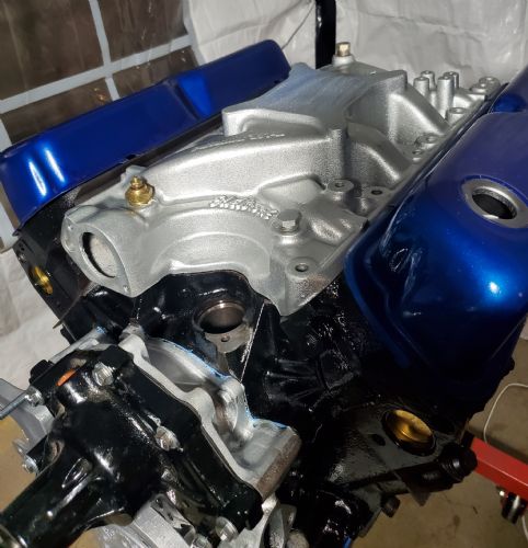

Just a quick update on what will hopefully be the last stage in this rebuild.
Engine long block is all done, which was the most challenging part. Found a place in Pittsburgh for final assembly as it's a three hour round trip to where it is now. However the door width is 8ft and I can't remember the total width with trailer. Think that will be enough? |
Grand Poobah Joined: June-06-2004 Location: United States Status: Offline Points: 11015 |
Since it's am 8 foot door, the opening is probably a few inches less due to finishing trim.
Somewhere, sometime a long time ago, I think I remember backing a same vintage SN on it's factory trailer through the opening for an 8 foot door with at least an inch or 2 to spare on each side Trailer width was the limiting factor, the boat is 76 inches wide but fender width is quite a bit more Somebody must have some measurements around here TRBenj is usually good for trailer info. Or............maybe you need to start a new thread with a title like " How wide is a #3 trailer from the 70's?" This is all assuming it's on a CC trailer built for the boat
