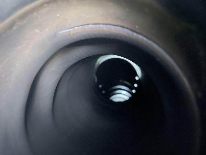

So do you have mufflers on that thing or hose all the way back to the transom fittings or some other arrangement. A 78 had mufflers originally.
I'd be checking everything after the manifold outlets to be clear and unrestricted especially the parts where there' are sharp bends in the rubber that you haven't looked at yet.
If you have mufflers you'll see some restriction baffles but it sounds like maybe they were removed at some time.

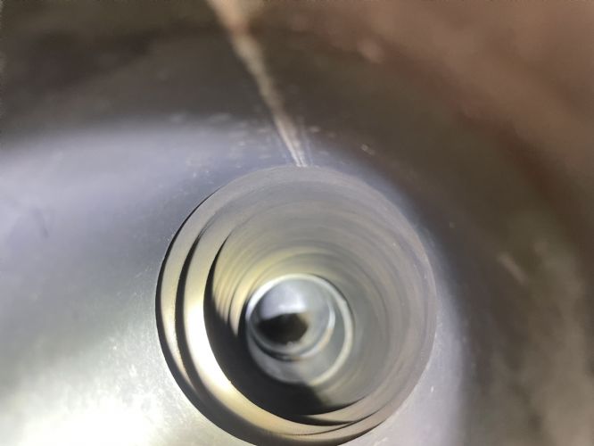

After closer inspection, it does look like it has mufflers (still learning what I am looking at here). The mufflers also appear to have possibly fiberglass baffles (looks like 2 per side) that then attach to the exhaust tube that leads to the manifold exhaust. I will need to remove the engine cover and some of the floor panels to access everything for a closer look. I did take a photo of the exhaust from the exhaust flap for clarity and reference. Its not the greatest photo, but it's the best I could get to explain what I am looking at. Both exhaust ports looked identical with no blockage at least at these points.
You can see the one baffle and there is another one further in that is not visible in the photo.
Next step is to remove the engine cover and some of the floor panels for access. Then start working on removing the exhaust hoses from the manifolds for inspection from the other end. I am hoping to get it done this week and I will update as soon I as I can confirm something one way or the other on a possible blockage.

2 baffles per muffler is normal and what you have in the picture looks normal for the rear baffle.
Good luck with the hoses.
