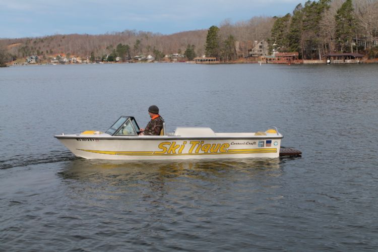

Below is the original post to this thread. Unfortunately the site was hacked and all picutures lost. Happy to send detailed pics to anyone looking at this thread with questions. Below see pics of before: And After: First up will be the engine and the trailer. Engine popped the freeze plugs in 2013 so we are on pins and needles as to engine...anyone know a good correct craft engine shop around the Carolinas? We are going to soak her this week and put a bar on it next weekend just to be cautious. 302 Commander. Otherwise I am very pleased with the boat. New floor and carpet, solid mounts, and from what I can see, all parts there. Trailer has a little left to be desired but it trailered well on the trip home at 65 mph. Pics follow (people in pics are seller and son). Realize now that I didn't get any interior shots. Those to come. And to all, Fram is on there. Don't worry, will change. Thoughts? Let me know what you see is askew. Questions: Oil and filter...same as my GT40? Anyone with pics of where these freeze plugs are? |

IAughtNaut
Grand Poobah Joined: August-22-2010 Location: TN Status: Offline Points: 2568 |
Very cool. let me know if you are looking for an assistant who doesn't know what he's doing.
Hollywood
Moderator Group Joined: February-04-2004 Location: Twin Lakes, WI Status: Offline Points: 13510 |
Pretty engine and boat. We will get you running again.
storm34
Grand Poobah Joined: November-03-2008 Location: Dexter Iowa Status: Offline Points: 4492 |
Nice purchase! Freeze plug isn't the end of the world (hopefully) just inspect closely for cracks.
Trailer looks like it could be brought back to original with the help of some Tim Benjamin fenders and a bow stop! Wix 51515 for the filter. |
Grand Poobah Joined: January-28-2014 Location: Folsom, CA Status: Offline Points: 3590 |
Very Nice!
8122pbrainard
Grand Poobah Joined: September-14-2006 Location: Three Lakes Wi. Status: Offline Points: 41040 |
David,
Nice find! Good luck on the engine. I sure hope it's OK. For oil, I suggest 20-50 with a good ZDDP content like Valvolene VR1. All the gel chips on the chines and stem are a pretty easy fix with a gel kit. FYI, the cotter on the prop nut is bent the wrong way. The one leg of the cotter gets bend over a nut flat and the other can be cut short or bent length wise parallel to the shaft. It's a very common mistake. Keep us posted on the engine. |

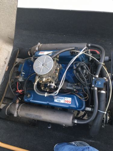

So quick order of near term events to come. Let me know if and where I am off:
-tonight. Pour a couple oz atf in each plug. Let soak til weekend -detailed visual inspection of block for cracks -put new freeze plugs in (any explanation on this process and placement?). I plan to look for the holes, feel around them for issues and then put the new plugs in and tighten. -weekend, turn engine with bar (there is an arrow on the main wheel, no?) -check water pump impeller. Plan to replace before trying to start in the future -if it turns (how many turns to get oil around?), hook up battery and compression test if the starter works and the wiring is ok? Or should we be looking to drive the oil pump with a drill. I read about this in the latest promo thread, although this engine has run more recent. Oil visually looks good on the dipstick. Should we change it before any of this process? Or change it after we test the block? |

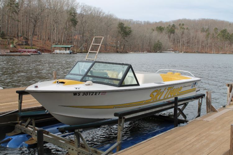

Grand Poobah Joined: June-29-2005 Location: NWCT Status: Offline Points: 21107 |
As I told David, the trailer looks to be quite a bit older than the boat. 4-lug hubs, raised coupler, early guide post style and cross members that don't extend at all (front) or minimally (rear) past the angle where the fenders are mounted. It would have had curved fenders on it originally, the square ones would have nowhere to mount. I'd be putting a cc-style bow stop on it in any case- either low or high style would be a big improvement over what's on there now.
Let us walk you through the engine... this is going to predate most marine mechanics expertise. You'll get better advice here. |

Riley
Grand Poobah Joined: January-19-2004 Location: Portland, ME Status: Offline Points: 7946 |
We picked up our '78 2 years ago with the same situation. The freeze plugs are along the sides of the block above the oil pan. Some of them are tough to get at because stuff is in the way. We bought some rubber compression plugs which were easier to install so we could get it running in the driveway.

Thanks to all for the replies. The seller handed me some rubber stoppers with nuts in the end, both in original packaging and two brass discs (assume these were the original plugs). Which to use? The rubber ones look like no explanation needed. Explain the brass if I should use them. I'll take pics tonight of the choices.

How to install block core plugs aka: freeze plugs
Bruce is correct. you may nee to remove things like the manifolds to replace the plugs. Rubber to me is temporary and very back yard. When you get it running, take the time to get the brass installed. |
Riley
The rubber is fine to get it running in the driveway. No sense taking the time to do it the "right way" if the block is cracked.
Manifolds won't be in the way, but the starter might be (usually it's the rear plugs that pop). Mounts may block access if it's a front plug for some strange reason. Agree with Pete, use the brass if you have enough access to tap them with a hammer (and large socket). I've gotten lucky in the past once or twice when the core plugs popped and prevented further freeze damage... obviously that isn't always the case. Hope it is this time though!

Can't and can't. Or at least I don't know how. Photobucket for the latter. That engine is so clean I completely overlooked the Edelbrock. Fine on Chryslers but I'd be searching for a 450cfm Holley marine unit with a proper metal fuel line. Not before getting the engine running (probably), but I'd put it on the list. |
samudj01
Gold Member Joined: March-10-2009 Location: NC Status: Offline Points: 931 |
Is the edlebrock stock? Is it an issue or is the Holley just preferred?
Previous - 99 Sport Nautique w/GT40 and 87 Martinique w/351 |
I don't think an Edlebrock marine carb was used on anything originally. Holley's and Quickfuel's are preferred,(the Holley's being oem) but some people particularly on other sites like them. If it works for you,you can leave it.
