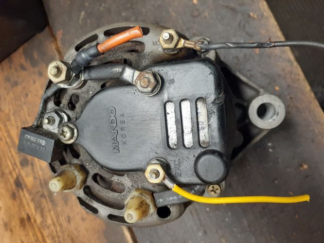

Is this a PCM 351? They'll all bolt up with very minor modification. The AMN 0002 will need a jumper wire between the "s" terminal and the output terminal and then it can be wired like in the mid 80's diagram below. They'll all do away with your external voltage regulator on your 76 The picture below shows where the jumper would go on the Mando style alternator. It's the strap between the "s" and output terminal with the black sleeve over it, but a 10 gauge wire works just fine. |
