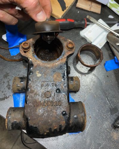

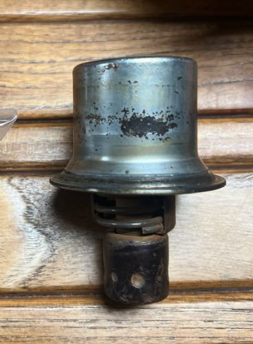

I have a '97 Sport Nautique with the Chevy 350 PCM engine. I need to replace the thermostat but I think what is in there is not correct. My questions are. What gasket is needed internally, o-ring, cork, etc? Does this gasket go in first and then the thermostat and then the plastic collar/spacer. What gasket do I need for the manifold attachment to the block? Which side of the thermostat should I see after I assemble it into the manifold? Thanks

The thermostat silver metal goes up into the thermostat housing and the dark area where the spring is goes into the intake manifold, Paul

If you click on the link below and go to page C4-1 and C4-2 you'll find your thermostat housing for 97 and later PCM engines
link It takes an automotive style thermostat like yours. It also shows the earlier one that took the big, tall, expensive one. The exploded view shows how it goes together Pointy side towards the sky It's not like Paul's

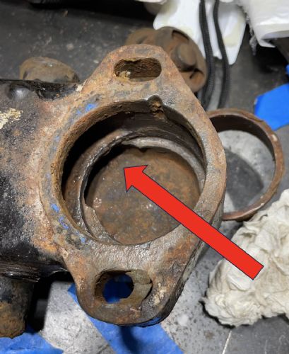

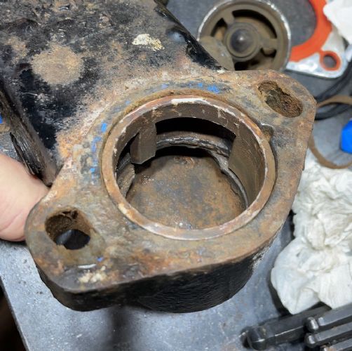

Is the manifold sealing surface to the thermostat broken or is this section supposed to be missing?

Grand Poobah Joined: June-06-2004 Location: United States Status: Offline Points: 10678 |
That's how it's built It's one of the flow paths through the housing. The retaining adapter (part #6 in the manual) goes in with it's opening lined up with that opening. The adapter only fits one way, there's a ridge that lines up with the groove at about the 1 o'clock position in your picture. As far as the thermostat, it won't hurt to try the 160, you may like it . If it runs a little warmer than you're comfortable with, get a 143. |

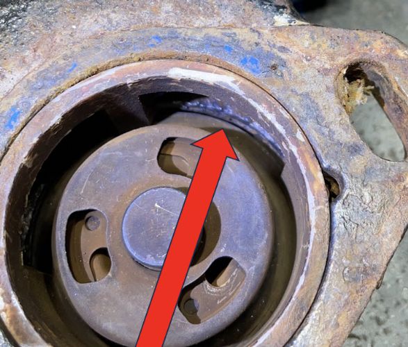

This is what it looks like with the adapter in

With the thermostat is I can see past the edge of it to the bottom of the manifold.
I still say that's the way it should be. A little bypass flow while the engine is warming up
Since you're thinking about a new thermostat housing, I'd at least try using what you have now. You might like it |
