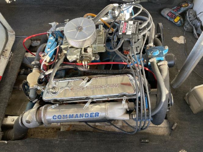

So, this where I am at. I have a 1986 Ski Nautique with a 351W Commander package. I had been storing the boat for a family friend for a number of years, but it sat due to mechanical issues but reportedly ran great at one time. They ended up leaving the state and I became the new owner and I have been working on it ever since. I feel I am very close experiencing the boats full performance, but I am stumped with some final acceleration issues and could use some advice.
Acceleration problem #1: On the water under load, when I give it throttle from idle it stumbles and dies. I does much better in reverse as there is not as much load as I have read. I can increase the idle and throttle my way through/around it but the high idle makes it tricky around the docks and is not a long-term solution and can't be great for the transmission. There was a previous post "Stalling in forward" that was very similar, but there was no solution posted. I have also followed the posted advice on setting the throttle cable linkage correctly as well.
Acceleration problem #2: On the water under load at about 2700 rpm, additional throttle does not increase RPM/speed. Which feels to me as if the secondaries are not opening. However, that is based only on what I suspect on what I have read. I have not had the opportunity to physically observe that this is the case as the GF has not yet agreed to help me check this on open water under load. Since she had to help me push this boat after it has died on the water once or twice already, I'm giving her a little room this one. LOL
Seems to run great once past the stall attempt from idle and to the 2700 or so rpms.
The following is based on what I have done, and some based on what my boat mechanic has advised. I will try to limit what was done in regard to acceleration issues.

Good job getting a picture posted in your first post.

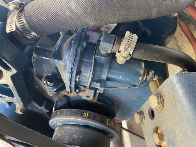

Here is a photo of the fuel pump that is on it now just for reference. Not sure why the photo appears sideways.

That's a Carter fuel pump and that little canister on the bottom held in place by the thumbscrew has a small filter inside of it. Maybe you already put a new filter in there..............maybe not.
Your ruptured diaphragm overflow tube must come out the backside of the pump and is camera shy in the picture. In your first post you can see the tube hooked to the flame arrestor
It looks in your first photo like you have a rubber fuel line, It could be original and coast guard approved or replaced sometime over the years with who knows what.
If you want to test fuel pressure, unhook the line from the carburetor and with a little extra line and a tee fitting you can have your gauge hooked up temporarily.

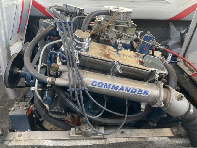

I have attached a photo of the other side of the engine for reference.  Thanks!

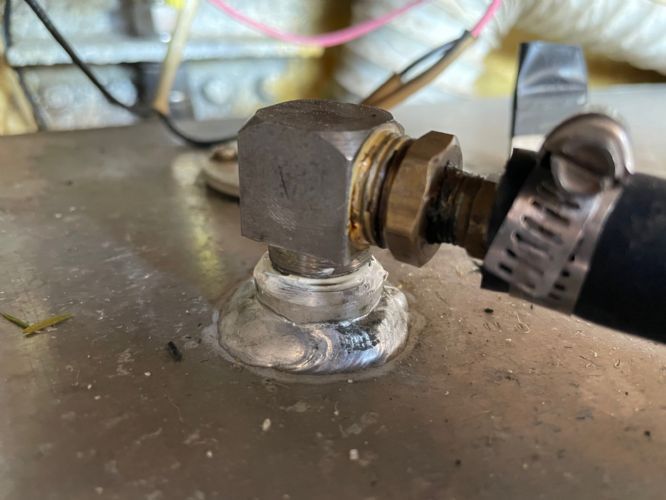

Ok, I got the fuel pressure and fuel flow tested before the peak of the heat today, so this is what I found.
The fuel flow at idle appears to be putting out a good amount of fuel, especially for being at idle (but that is my novice opinion). I would say it would be in line with the 1/4 gallon at a 30 second run as suggested. I did not actually time it out to 30 seconds as I was doing this project by myself and dealing with fuel I was trying error on the side of caution with everything going on. However, it was not a completely steady flow at idle. I attached a rubber fuel line to the end of the fuel line that attaches to the carburetor and then ran that line into a gas can. When I observed the fuel flowing into the can it was pulsing a bit as if in sync with the pump. There were no breaks in the fuel delivery but you could definitely feel the fuel pump working in the rubber fuel line. I am not sure if this is to be expected (seems logical though) since I have never tested fuel flow before.
The fuel pressure was at 6 and I tested this a couple of times. I also checked the fuel lines from the carburetor all the way back to the tank for any binds or collapses and everything looked good.
In dealing with this fuel line again after awhile (one of the first things I tackled over a year ago), I now recall when I cleaned the pickup tube and anti-siphon valve (not knowing what it was called then), the valve did not appear to have a ball or any other part in it, if I recall correctly. I wasn't sure at the time if it was just how the fitting was made or not so I just cleaned it and moved on. Now that I am a bit wiser (and I do mean a bit) that issue needs to re-addressed. In reading today, its a huge safety issue as well so I will put it on top of my list to find a new one. Although, I know the line/valve was cleaned and not obstructed.
Below is a photo of what I am referring to when I say anti-siphon valve for clarity (assuming I'm correct).
Would the unobstructed anti-siphon valve cause any of the symptoms? Perhaps a reason for needing some throttle to start hot and cold? Any thoughts on the fuel flow, fuel pressure or are we headed to the carburetor? Anymore homework assignments?
