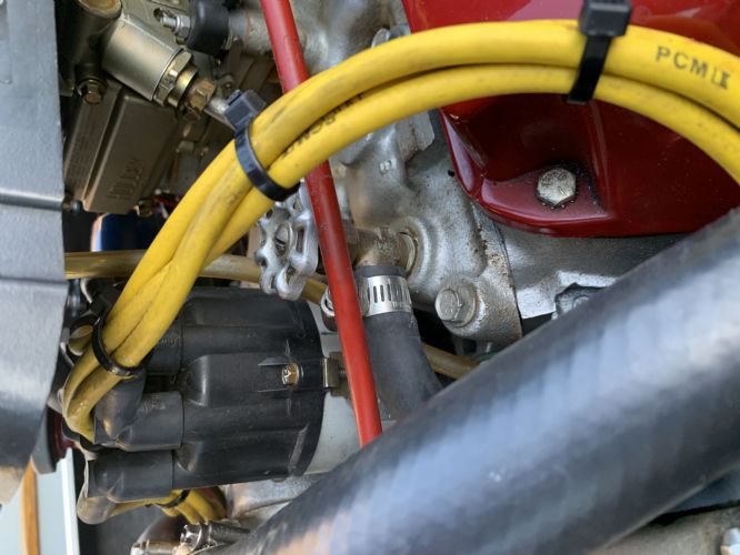

Hey Thank you PLBC! I went out and removed kick panel and exposed the heater box. I turned the engine on and hot water is leaking from the box not the hoses. So, it looks like I blew my heater core?
I traced a line back to the engine where there is a valve. I'm assuming that is the shut off valve. Would that be the only one? |

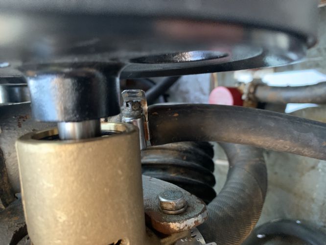

Post a picture of the shut-off valve and heater plumbing at the engine block...just in case.
SteveK ![]() Newbie ![]() Joined: August-31-2024 Location: Orange, Ca Status: Offline Points: 9 |
I haven't posted a photo, but I'll certainly try.
I'd like to just disconnect it as were in Arizona and rarely if ever need a heater, and my son want to ski in the morning!

My Hot water turned out to be a leaking heater core. I'm going to connect the two lines that feed the heater box together in the morning as a temporary fix until I replace the heater core.
Thanks for your help. |
89 Ski Nautique
Jonny Quest ![]() Grand Poobah ![]() ![]() Joined: August-20-2013 Location: Utah--via Texas Status: Offline Points: 3030 |
You are correct -- you can remove the supply line and the return line at the heater and then join the 2 hoses together with a barbed union and hose clamps. Many boats were outfitted with heaters from Heater Craft. If you go to the Heater Craft website, it will direct you here for parts.
If it makes you feel any better, the heater core problem you described is not uncommon. JQ
