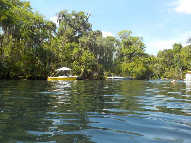

Post Options Post Options   Thanks (0) Thanks(0)   Quote KENO Quote  Post ReplyReply Direct Link To This Post Posted: April-16-2021 at 6:23am
Might this be a picture of Tweetie at the SJRR?
Was she tweeting along nicely?
That's my kind of sun shade she has there, I like it Wink
Nautiquehunter View Drop Down
Joined: December-31-2008
Location: Lake Lanier GA
Points: 1010
Post Options Post Options   Thanks (0) Thanks(0)   Quote Nautiquehunter Quote  Post ReplyReply Direct Link To This Post Posted: April-16-2021 at 7:53am
Yes that's her . She spread her wings in Florida last week. Moorfoot banned me from putting a bimini on it . I found this on Amazon.
