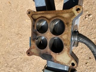

Now to my homework. I will attach a close up photo of what is on there now. I replaced both the gasket on top of the wedge plate and the one under the wedge plate. I can't recall if I got the PCM gaskets or used what came with the new QF carb. I know we discussed it but I just can't recall. I do know that the gasket between the carb and the ge plate is a thick gasket. The one under the wedge plate is not as thick for sure. Under the wedge gasket may be another riser but I can't quite tell. It looks like it has more of a casting mark around it then it actually separates. I never removed it and if I recall correctly it was threaded where I mounted my new studs for the new QF. Maybe the photo will help. I know I spent a significant amount of time with carb cleaner and even some propane looking for a vacuum leak in those areas with no luck, but it doesn't mean I didn't miss one.  Thanks again for the help and let me know what you think. The photo may come out sideways...we will see...but it should give you a better look.

I'd say you have a spacer o top of a spacer there.
This quote from the post on the QF installation kinda backs that up also, with the mention of 3 1/2 inch studs at the rear of the carburetor You'd only need 3 1/2 inch studs with 2 spacers.
Originally posted by AZ86SKI AZ86SKI wrote:
I did want to share a few things in getting it installed that may help others in the future who decide to go the QF route. If you are using the Holley 12 degree wedge under your QF, the 3.50" carburetor studs in the rear worked perfect for me. The mechanic had used bolts (not sure why) in the rear with the 4160 which will not work with the QF as there is not enough clearance to insert a bolt on one side.
Nothing terrible about using 2 spacers, but the picture sure looks like original paint not only on the original spacer but also the gasket edges..............like the gasket is original and never been off/replaced.
That gasket between the spacer and the manifold can cause plenty of issues if it's bad and it won't show up as an external easy to find vacuum leak either
I'd get 2 of the PCM RM0054B gaskets and remove the spacer and replace the gaskets above and below the spacer.
I've had those spacers come off real hard at times and real easy at others, but you should get it off  and replace the gasket.
It may or may not cure your issue, but nothing else has either Wink
Here's a link to a recent thread with pretty similar issues that were fixed by replacing the old gasket under the spacer
Agree, as it looks as though the PCV nipple is below the wedge, and on a spacer as was usual on Commanders of the day.

Well...that is something that definitely needs to be addressed. Especially since it is a 37 year old gasket with original paint. Great catch! What I documented regarding the stud threads versus what I recall definitely support that as well. I have spent so much time starring at this motor that I am beginning to second guess myself at this point. Whether it is ultimately the solution or not it needs to be addressed and gaskets are way cheaper than new carburetors and distributors. Big smile Although this boat absolutely needed those as well. Thank you for the link as well. Very similar issues and hoping for similar results.
I will get those ordered today and they are all getting replaced. I will also try to remember to take a few photos of the old ones for reference when replacing. Thanks again, I really appreciate it.

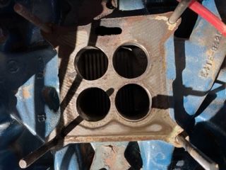

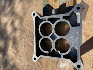

The new gaskets arrived and I decided to tackle this latest project with the carb spacer and the original gasket. The bottom spacer came off relatively easily and mostly in one piece, which I was pretty surprised. There was some fuel moisture under the bottom spacer on top of the manifold. I can't imagine that is a good thing. I cleaned the spacer the best I could but noticed a small rock to it when I laid it on a flat surface. Even though the rock was very slight and it had what appeared to maybe be some rust, I decided to drop it off at a machine shop and let them do their thing to make it right. They just called and it's good to go. Here are a few photos for reference. This is something that absolutely needed to be addressed and I am hoping this will solve the remaining issue. Thanks again for all the help.
Bottom of spacer with original gasket attached.
Manifold. On the bottom of the photo is where it was a little wet.

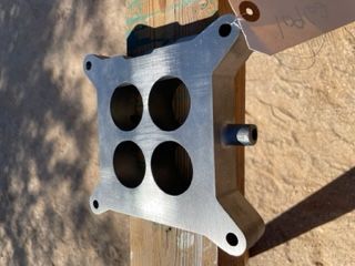

Just a few quick photos of the spacer after the machine shop. Quite a difference and well worth the 60 bucks in my opinion.

I got the original spacer put back in with two new gaskets that KENO recommended. I deleted the additional wedge spacer on top. So just the carb and the original spacer now. When KENO stated that two spacers isn't terrible, I'm pretty sure he also meant it wasn't great either.Big smile
I hooked it up to the hose and fired it up. It definitely sounded different. It sounded like it was loping/stumbling a bit. So something changed with the new gaskets. I hooked up the vacuum gauge to the PCV line to the back of the carb and what used to be in the steady-ish 15 range was now bouncing around down to 11.

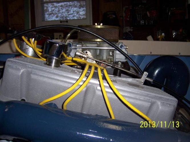

The Commander engine in the photo a couple posts back seems to be at more angle than most?   Maybe I am just used to looking at the newer mountings with the 1.23 tranny that allows the engine to be mounted more level.
Post Options Post Options   Thanks (0) Thanks(0)   Quote Gary S Quote  Post ReplyReply Direct Link To This Post Posted: October-14-2023 at 1:46pm
I think your getting used to looking at the newer engines and trans. I believe the older setups were all at 12 degrees across all makes but not positive. Here is an old picture of my HM they did use a wedge

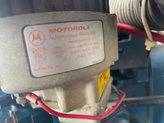

If you want to get a new alternator, punch that PCM number into Google and find the same thing for about half of the Discount? Inboard Marine price and spend the other half on something for the GF.Wink.....or ask here for a link to one of these outfits.
Either way, there'll be some wiring changes.
They're just selling you an aftermarket version of the original Motorola/Mando from the 80's, 90's at a not exactly discount price unlike some places that actually give you a good deal.

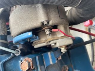

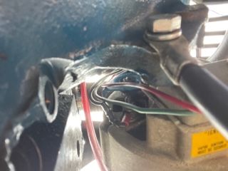

I was unable to get a reading at the back of the alternator. There are three wires. Red, green and black coming off the back of the alternator. The black wire connection was located on the back side in a tight spot, and with the belts running, I decided to pass on trying to get voltmeter on that negative post wire. I did attach the to the red post wire connection and tried to ground onto something else with the negative lead but it was giving me some strange numbers, and electrical not being my best subject, I thought I would check with you guys with what we have so far. Open to any advice on getting a reading on the alternator if still needed. That negative wire on the alternator is in a pretty tight spot.

What kind of funny readings were you getting at the Red output terminal? Was it fluctuating up and down and not a steady reading?
I looked for a picture in this thread where the alternator might have photobombed it's way into the picture, but didn't see one. Wink
Do you know what brand it is or maybe you can post a picture  Kinda hard to get a picture of the back, but that would be real helpful.

Thank you for the quick replies, especially while I still had the boat pulled out and still hooked up on the hose.
First, I wanted to address 63 Skier's question. I know this is getting to be a long post to follow with all the past issues. The last trip to the lake was after replacing the original gasket under the carb which greatly improved starting, idling, re-starts and even better throttle response. This just left the last remaining issue of not being able to get the boat over about 2500 rpm under load. Then this electrical issue arose with the final start at the lake being weak and the voltage meter reading 11 volts all the way back to the dock. So the issue of not getting over 2500 rpm under load remains along with these new electrical questions. I hope that answers what you were asking and thanks again for the help.
So here is what my homework revealed...
With the boat off, the battery read 12.73 volts. I then ran an ohms check between the black wire post on the alternator and the main ground on the engine block. It read 0.00. I am assuming that's what we were looking for.
With the boat running at idle, the voltage gauge on the dash read about 13 volts. The battery read about 14 at idle. When I revved the engine the voltage gauge on the dash dropped to about 12.5 but the battery jumped from 14 to 14.08 or so. So, something is not accurate here, my guess is the dash gauge but that is just a guess. I did not take any readings under the dash yet.
Again with the engine running at idle, with the positive lead from the multimeter attached to the red wire connection at the back of the alternator and the negative lead to the main ground on the engine block the readings constantly fluctuated between 4.44 volts up to 5.64 volts. I have no idea if this is good or bad.
Here are a few photos of the alternator for reference. I also failed to mention in my last post that there is also a light blue wire connected to the back of the alternator as well. It's a larger gauge and appears it may be the same wire that runs to the breaker. Just FYI.
Hopefully this is helpful in determining whether we have an electrical issue or not. I did however learn how to test ohms on a multimeter, assuming I even did it correctly Big smile. Any thoughts? Thanks again for the help.
Post Options Post Options   Thanks (0) Thanks(0)   Quote MrMcD Quote  Post ReplyReply Direct Link To This Post Posted: November-16-2023 at 3:09pm
The main wire from your alternator to the battery should be a large wire.  The alternator even on an old boat will probably put out 45 AMPs to charge your battery and maintain the system.  That main wire has to be large enough to handle 45 amps, it might be a 6 foot long wire and the ability to carry amps drops based on how long the wire is, longer runs need a larger wire to produce the same results.  I am thinking you might need a #10 wire from the alternator to the Battery.   The other wires activate the alternator and do not carry large amp loads but the charging wire needs to be heavy.
You could make sure all the connections are clean and tight on the rear of the alternator but it seems to be working so far.  First sign the wire is not large enough would be that wire getting warm or even hot while the alternator is charging the battery.  The entire gauge cluster can be taken out for inspection and give access to those wires in the back of it.
Points: 11212
Post Options Post Options   Thanks (0) Thanks(0)   Quote KENO Quote  Post ReplyReply Direct Link To This Post Posted: November-16-2023 at 4:55pm
I think that you might need to take the alternator off of the engine to tell what the terminals are labeled and which color wire goes where.
But in the meantime, take your multimeter and check the voltage at the light blue big wire. Pretty much guarantee you'll find about the same voltage as battery voltage, cuz it's the heavy output wire that goes from the alternator to the breaker as you mentioned and from there it goes to the solenoid on the back of the engine (near the breaker) and hooks to the same terminal as the battery cable that goes from the battery to the solenoid. That makes your charging path  It also explains why you have some fluctuating readings on the Red wire since it's not the alternator output.
That red wire may be on an AC tap and if you put your multimeter on AC volts and check your voltage on the Red wire with the engine running, it probably won't be fluctuating and you'll have a steady AC reading..
Where that red wire goes seems to be a mystery right now, so like mentioned earlier, the best thing you can do is mark what wires are where and take the alternator off for some good clear pictures of the back and follow the wires to the other end wherever it might be...especially the Red wire.
That Red wire definitely has that "homegrown " look to it. (The crimp on the ring terminal isn't factory original.)
There's no good wiring diagram floating around for a 1986 Commander 351, unless someone pops up in this thread with one.
Why there's a big Blue wire on the alternator output instead of the industry standard Orange is another mystery
PS........the picture below shows some fairly ugly wiring around the unused ballast resistor, maybe a picture of that wiring from above would be good too.
