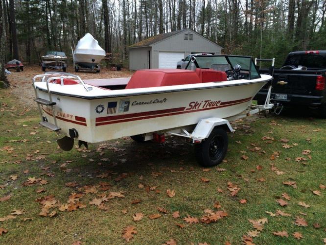

Yea and now days Pete with a Acme prop you'd slip and end up cutting off a toe If I had some gel coat left I'd just remove the dumb thing. Mike lay on the floor of your living room with your butt against the wall,put your feet up the wall with your knee's back by your ears. Now imagine trying to pull yourself up
Here is the best picture I have of mine. |
