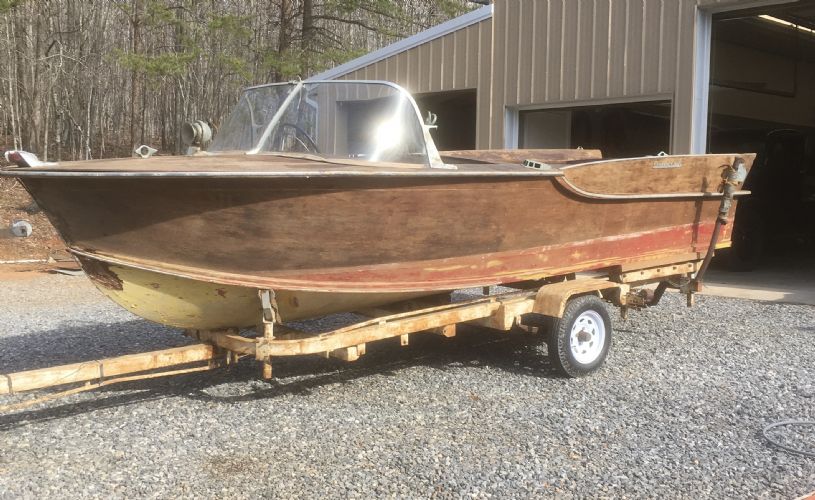

Thank you for the reply, Riley. Yes, it's a plywood boat with the Fins, So strange that their Cool.
Definitely a project. The Starflite will be next winter's project. I have a Chris Craft Riviera to finish up first, But I'm trying to educate myself on the Correct Craft such as proper stain color, floor finish, interior colors etc. ![]() |

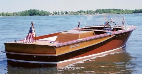

![]() Different boat than yours, but similar vintage and good example of colors.

Riley
That is a FINE looking boat.

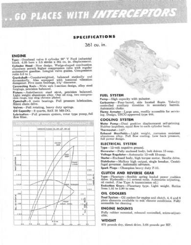

A little info from somewhere on the internet,

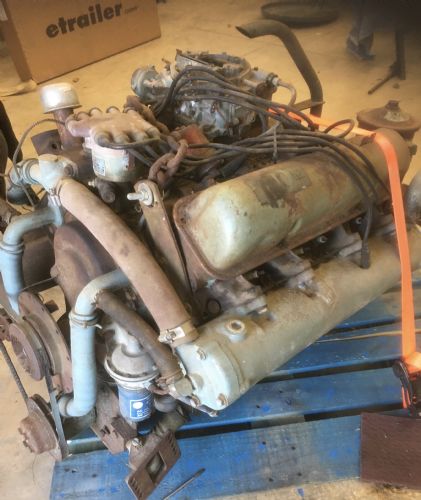

You are correct 70cc. Big block Ford Fe. Dearborne Interceptor 361 cubic inch 240 hp coupled to a 71B velvet drive.

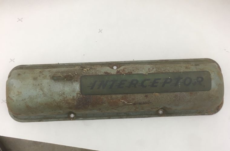

Right hand prop on the boat so I'm assuming reverse rotation engine. Engine and transmission to be rebuilt. (if the block is any good). I've seen this motor in another Starflite on the internet and it was painted ford blue but appears to me Dearborne used more Greenish blue? I also would like to get reproduction decals for valve covers. ![]() |

Fantastic! Looks fairly clean and complete.

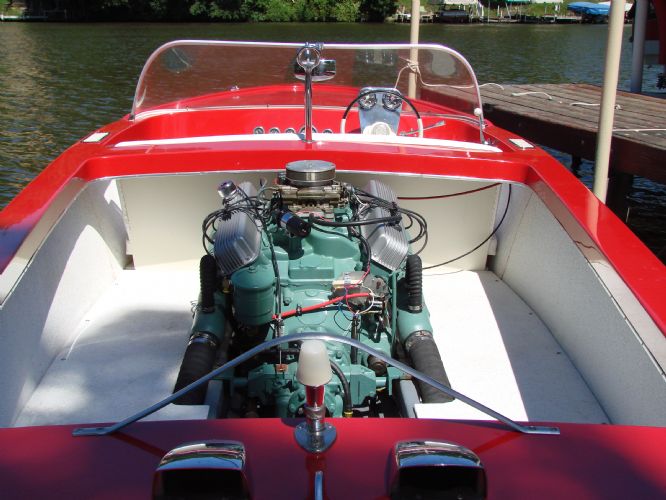

I have a slightly newer version of that motor in my 65 Nautique which now has a 390 block. I think the 71B is fairly rare and has a longer input shaft and different spline than the more common 71C, so takes a unique damper plate which might be hard to find - assuming you want a new one when everything goes back together. If you happen to convert to the 71C, you'll need a different bell housing to accommodate the shorter input shaft. I bought two donor FE Interceptors to complete my project, one had a 71B, so I have some spare parts in case you need anything. -Phil |

Thank you Phil. Sweet looking boat you have there! Your motor looks like the correct color or very close from what I can tell from a picture.

I used Duplicolor Alpine Green, available at Napa. There's been some debate on the color, but it's a perfect match to the original paint that was on the transmission and oil pan and dipstick that came with my boat.
Earlier Interceptors, especially those with Y block Fords seem to be more bluish in color. Have fun at Mt Dora!
