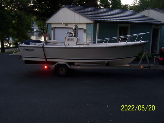

Gary, sweet ride, that Shamrock looks like it has great bones to start a project with

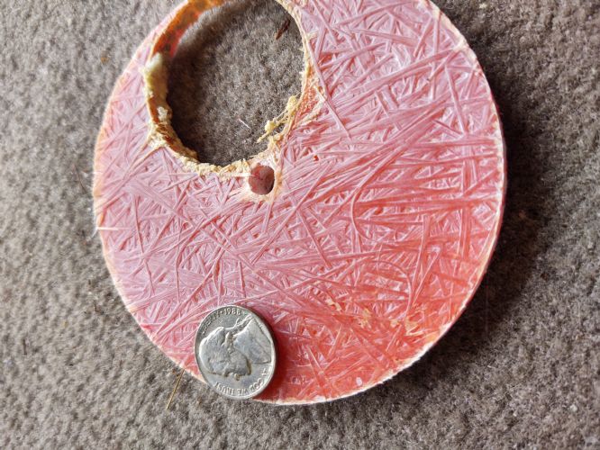

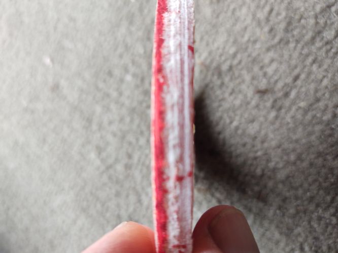

I'll take a closup tonight of the cores from the hole saw. its an odd material/layup. a honeycomb core that has white powder in the voids, like gypsom perhaps. it looks like a panel that was pre-made,  and cut then bonded in.
yes,indeed just as you suspected,  Panel was pre-made, cut, bonded in, the foam certainly was poured afterwards.

Tim, this was my first hole in the floor i cut to examine the foam. its a peculiar layup, a thin honeycomb core, white powder inside, that was apparent when i feathered the edges before patching.  Hot-glued some corregated polyethelene below the hole to support the layup
