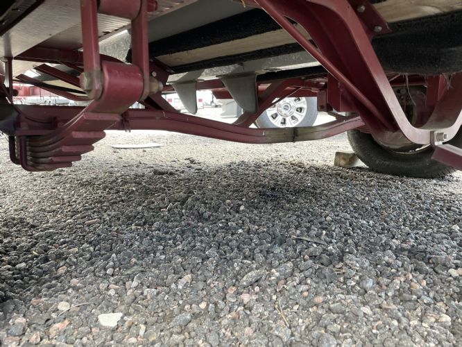

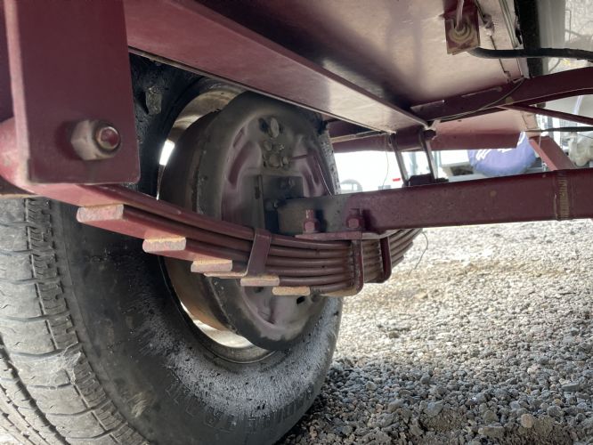

i have a 1988 Martinique single axle trailer and need to replace the axle
could not find any details on axle such as a plate or stamped detail boat in storage and not able to take to repair shop so working with mobile service guy Any details you can provide would appreciated Matthew 303.8804288 303.880.4288

I have to ask, why do you need to replace this axle this one looks like it isn't even rotted from your pictures. These axles are not a common bought off the shelf item like trailer shops would normally carry because of the bend in the axle to clearthe skeg(s). but the factory xle should be a 5200-6000# rated axle. with a 1.75 and 1.25" bearings if you are replacing its going to most likely be a custom made axle from a fab shop unless you find a doner trailer/axle. (if you do find a doner and it has paperwork let me know i'd be interested in it! I gave up trying to title mine years ago) |

You could use a straight axle and just mount it under the leaf springs instead of on top. It would raise it a couple of inches but should clear the skegs. It's a different boat and trailer but I swapped out my drop axle with a round straight one many years ago and have never had a problem. The '92 was already mounted underneath but I switched from square to round. I also ditched the brakes and just have idler hubs.

Hes right. You cant BOLT on a new spindle. But those are pretty standard peices you can buy but you need a good metal guy who can cut the old one off and weld a new one in keeping it aligned. I have done it before on a car hauler i owned. *Btw* that part i did not check any measurements i just grabbed one for example.you will def want to verify before ordering. |

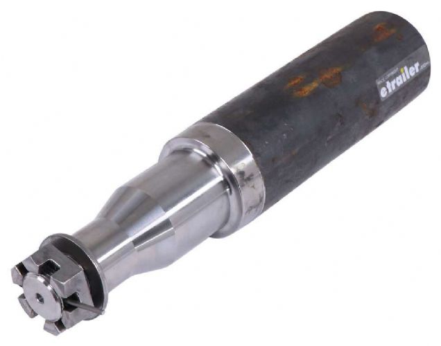

Had my hubs apart today and measured them up, It is what they call a #42 Spindle. a replacement spindle can be had at the link below. I think they can be found much cheaper than this site but this site had a good picture and dimensions called out. This is what I would purchase if my spindles ever need replacing. |
