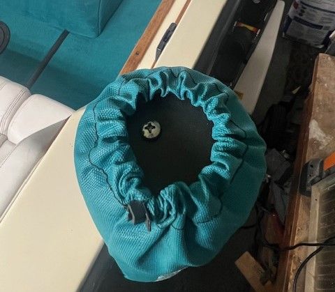

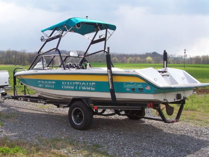

We’ve owned a 1992 Sport Nautique for many years. It sits on a stock CC single axle trailer. The guide poles have always had a home-made cap thing on the top to prevent the guide pole covers from floating up and off (I assume). The pads/covers are VERY loose on the poles. I’ve ordered replacement pads from Nautique Parts. I’ll have to knock those weird caps off the top to slide the new ones on. The new ones are closed at the top. So here’s the (dumb) question. Are the pads supposed to just float up when you submerge the trailer for launch/recovery? My boat fits relatively snugly between them. Am I going to be fighting the stupid things every time I launch and recover? On another post, someone said there is a drain hole in the guide pole somewhere (I haven’t looked at mine—-boat is a couple hours away). My poles curve at the bottom, 90 degrees, and attach to the trailer. I just redid all that hardware and don’t recall seeing any drain holes, nor am I sure what that has to do with the pads floating but what do I know? I fly airplanes. lol I saw on another post (yes I searched here first) that someone suggested using silicone to hold the pads onto the posts. Not sure I want to do that, as it’d be a real pain if I have to replace them again. Thoughts? Thanks! Fire away! |

The covers should be able to slip right over those caps
without any problems. The covers will stay on when you put the boat into the
water. And yes the pole guild covers will float up but they will not come off
on the poles. The covers will turn around when unloading or loading the boat back
on the trailer because the boat will rub up against them. So, there is no way
glue them on to velcro them onto the pole. |

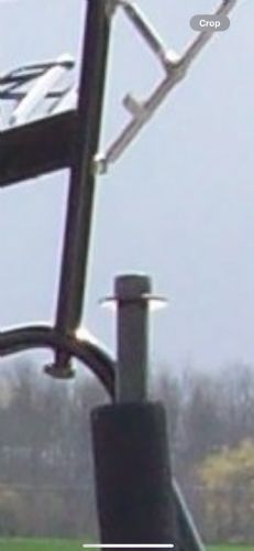

Thanks! The caps on the poles have large washers underneath them to prevent the pads from coming up past the top of the pole. So once I remove them to put the new pads/covers on, they’ll be able to slide up. Sounds like that’s just normal as the trailer is submerged and they’ll fall back down after it’s pulled out of the water. Thanks for the reply! 🙌🏻

Yeah my setup is a large washer with a cap pressed onto the top of the pole
