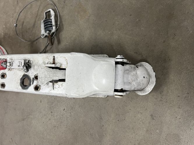

MrMcD ![]() Grand Poobah ![]() ![]() Joined: January-28-2014 Location: Folsom, CA Status: Offline Points: 3658 |
Old Atwood, all parts removed before it was cut off the trailer frame. I have all the parts from inside the Atwood.
Posting pics is not easy. I will keep trying
