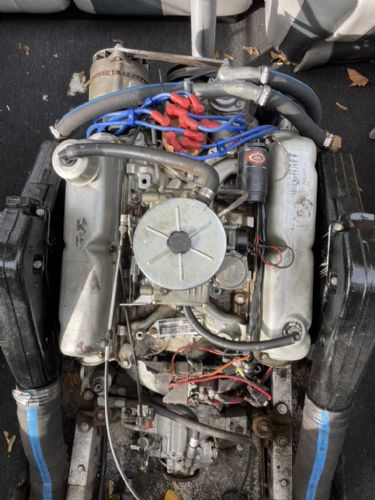

Attached the gearbox to the engine, and dropped it into the cradle.
So now come the questions Smile
-Attaching the belhousing to the engine.
I sorted the screws in a separate bag for the belhousing, but these don't seem to match... I have 2 bolts (the longest ones) that fit nicely in the bottom hole, on each side of the housing. (marked in RED below) I'm guessing these are the 2"3/4 ones. above those holes you have the "guide holes" and on top of these you have the Holes for the studs I believe? (GREEN) For the top 2 holes (YELLOW), the blowapart states that I need  2x 1"1/4 bolt. Which are not in the bag. The reason I'm confused is because the bolts I do have in the bag are too long but one has a painted head and the other one doesn't, this would make sense because one of the bolts is installed inside of the bellhousing (under the starter), so it wouldn't be painted over during the painting process)
So either I'm loosing my mind or the machine shop took the bolts out of the bags and switched them up by accident...
-Engine support blocks
I have 4 Engine support blocks, is it possible that there are 2 that go under the engine mount pad and 2 that are placed on the inner side of the transmission mount? Or maybe one on top of the cradle and one beneath it?
andrewmarani View Drop Down
Joined: May-31-2005
Location: Baltimore, MD
Points: 259
Post Options Post Options   Thanks (0) Thanks(0)   Quote andrewmarani Quote  Post ReplyReply Direct Link To This Post Posted: April-14-2025 at 9:24am
Looking at pictures of my 86 silver nautique engine, I only had two engine support blocks and they went under the front two engine mounts, on top of the aluminum cradle.  Picture is BEFORE the rebuild, everything is much prettier now.

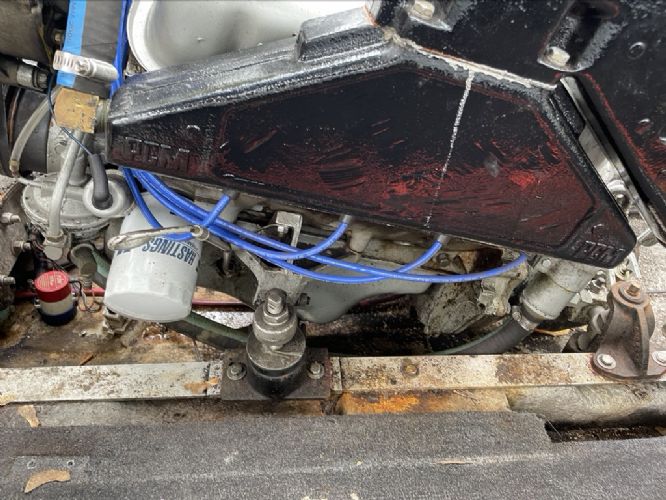

I did some digging in the photos that were made when this boat was disassembled. (2005)
Found this:
First picture showing the engine mounting plates on top of each other. Can anyone confirm this is how its supodsed to be on a 1986 BFN?
Second image showing the transmission mounts, only attached on the top and no bolts on the side. there's quite the gap between the cradle and the mount. Not sure that's the way it's supposed to be...
Points: 21213
Post Options Post Options   Thanks (0) Thanks(0)   Quote TRBenj Quote  Post ReplyReply Direct Link To This Post Posted: April-15-2025 at 12:32pm
Not uncommon to see some blocks under the front mounts. Boat was designed with both Chevy and ford engines in mind. Notch in stringer below the mount is to get the nuts on the backside of the through bolts. It’s common for there to be a small gap on the vertical face, it’s not critical. Obviously the tabbed cradle boats (89+ SN) don’t require any vertical support. Can’t recall if that angle on the underside of the mount is sharp or radiused, might not be possible to get the mount all the way in on a piece of sharp angled aluminum like they could on the radiused stringers (cradle-less) boats.
Joined: May-31-2005
Points: 259
Post Options Post Options   Thanks (0) Thanks(0)   Quote andrewmarani Quote  Post ReplyReply Direct Link To This Post Posted: April-15-2025 at 1:13pm
Engine mount has a sharp inside corner.  That's the back mount but the front mount has the same sharp inside corner.
Builder
Points: 21213
Post Options Post Options   Thanks (0) Thanks(0)   Quote TRBenj Quote  Post ReplyReply Direct Link To This Post Posted: April-15-2025 at 4:23pm
Could be deceiving but looks radiused in that pic.
Joined: May-31-2005
Points: 259
Post Options Post Options   Thanks (0) Thanks(0)   Quote andrewmarani Quote  Post ReplyReply Direct Link To This Post Posted: April-16-2025 at 4:02pm
I expanded the original picture on my computer..., just a touch of radius, an 1/8 or less at a guess.  Didn't interfere with my engine placement, would need less than an 1/8" on either side of the cradle to clear it.
Builder

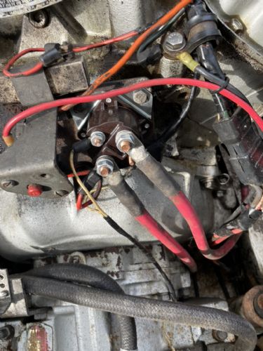

A new day a new mistery:
I'm reconnecting all the electric parts of the engine, but the distributor has me scratching my head a bit. In the pictures I can find of the engine (still assembled in the boat) the Ballast resistor is disconnected. the ignition + wire is connected directly to the coil. Could it be that this was done because the boat used to run on LPG? (You can see it on the picture of the engine above, with the questions about the engine mount blocks) Or maybe it's a high resistance coil? I'll double check the label on the coil this evening.
Joined: May-31-2005
Points: 259
Post Options Post Options   Thanks (0) Thanks(0)   Quote andrewmarani Quote  Post ReplyReply Direct Link To This Post Posted: Today at 8:07am
My ballast resistor is also disconnected and has been as long as I can remember.  As an aside, in the picture the heavy red and black wires that are zip tied to the main wire harness (just above the black connector) run back to the dashboard to deal with voltage drop created by the undersized power wires in the main wire harness.  I also replaced the old distributor with electronic.
